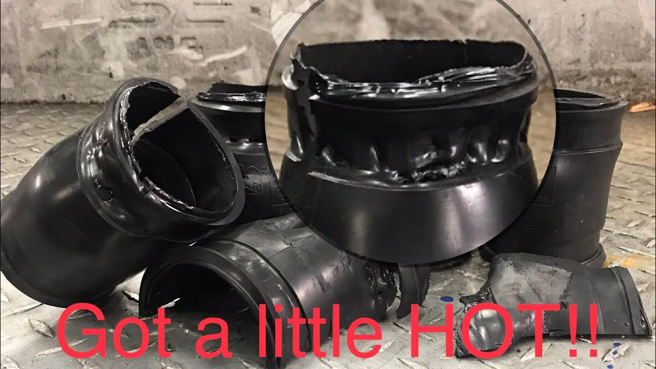

This video was supposed to be out yesterday morning, but I kinda got in a fight with the memory card in the go pro, what use is a 4k camera that only uploads in 1080p? Beyond me why it did that but oh well, I didnāt want to toss the footage since it was my first failure on the truck. She can get pretty hot
Iām not really sure if it was because i was running out of wood that the funcos melted, or maybe the minor air leak I discovered ignited the gas and caused the melt down. also i have nothing to base the cross over temp on, I donāt know what it should be. it seems it wants to be around 600-800f, but periodically it will start climbing into 900+, and i seem to start losing power at about 1100f in the the cross over. once it gets over 1000f, it really does not want to cool down for nothing. I may be over pulling the gasifier I really donāt know. below 45 mph the temps will not climb that high, but 50-55mph sometimes it will start climbing temp and not want to come back down. Really donāt know what it is doing. This morning it was getting hot and I opened up the air valve and left the fuel pump on and let it hybrid drive at 50mph for a while and temps still will not come down. I switched back to wood and it eventually creeped back down to 700-800f when I got into town and traffic slowed me down to 35mph. I donāt want to deduce that the restriction needs to be opened up, but it would makes sense to open it up would drop the temps some, but Iām not convinced the heat exchanger body is sealing up completely and a potential air leak of minor proportions is causing the intermittent high temperatures

no damage was done, just the rubber connectors which are rated at 200f and they got hot enough to sag down and start separating, introducing a large air leak right at the center post on 5 out of 6 rails. That was the easy fix, what I donāt understand is this seemingly not predictable high cross over temperature. But I have nothing to base my temperature off of, the Toyota only has a gauge in the center post where gas has cooled down a lot already. Hey @Wayne what temps do the crossover in your v10 run at? And have you ever had this occur in your truck or the Wilbur smith build? How about you @JocundJake you have the same style cross over as i built, what do your temps run at normally?
