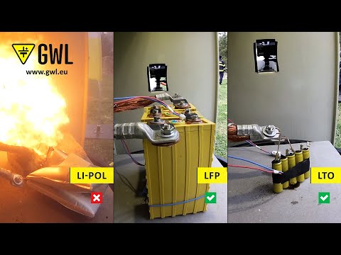

I saw this video showing testing if the different types of lithium batteries and figured people here might like to see that there are a couple of different types that actually are not much of a fire hazard even when over charged or damaged.
We had kind if the same situation, but a little uncontrolled. Since then Lion is out.
