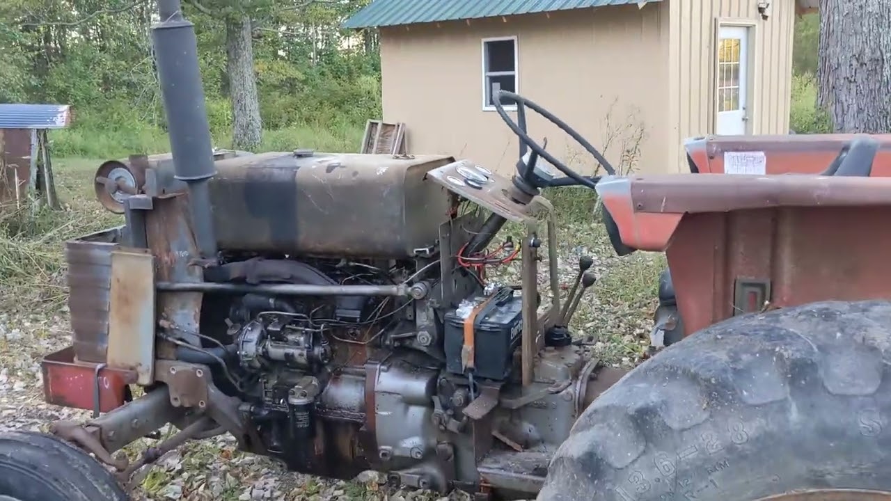

Sure enough, the arm welded up just fine, and I managed to get a 7 acre field bush-hogged. Here’s the tractor running, before and after the repair.
Before:
After:

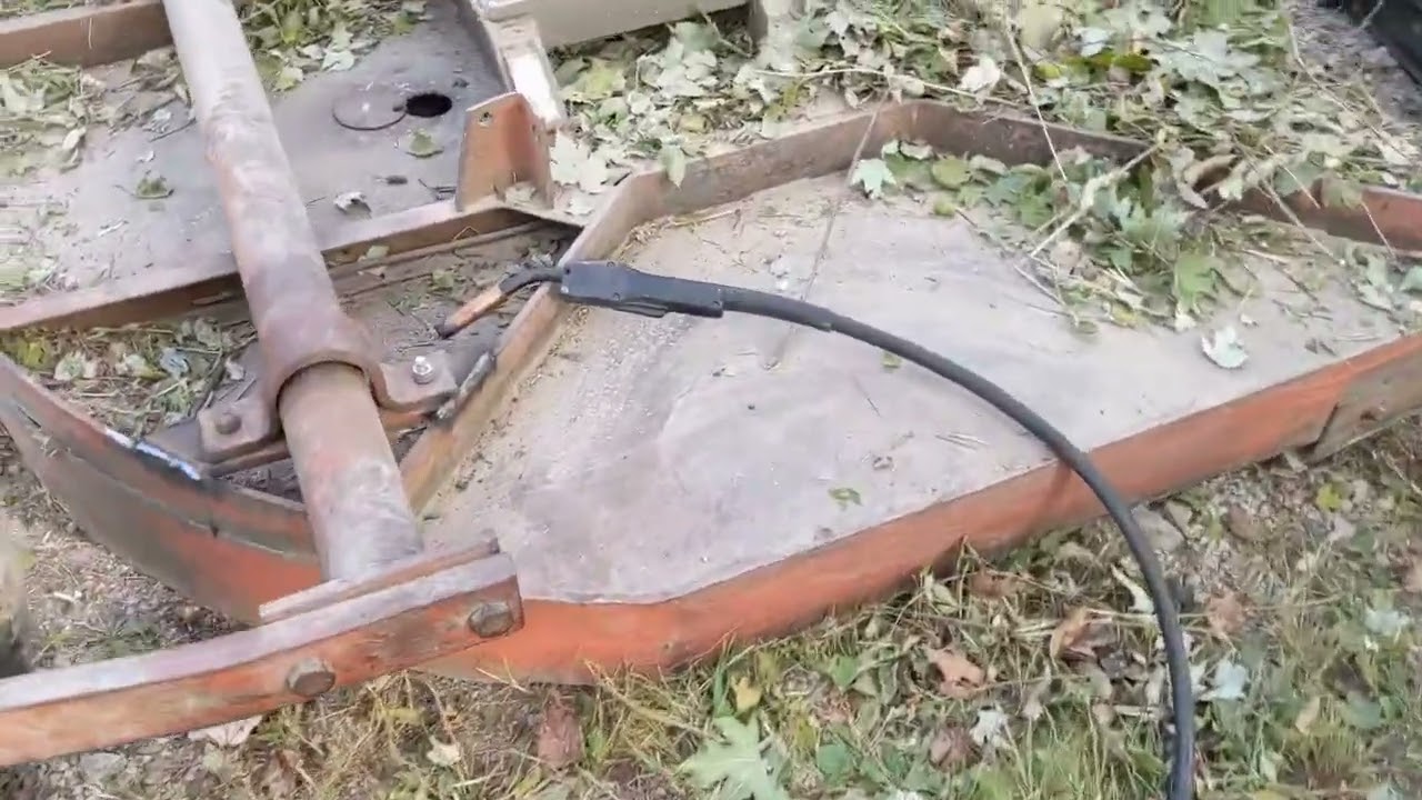

I managed to break the bushhog axle mount while mowing, and I was able to weld it back using a PTO generator I got recently. First real test of that. I didn’t get video of actual welding but you can see the results below. Not my prettiest weld, but strong enough for the job.
Then, after I finished up that field, the rough running came back. I thought to myself, well that weld didn’t last long. Here’s what I found after I opened it back up:
Nothing at all wrong with my weld! A totally different rocker arm failed (#1, front of engine). I welded that one back together too, did yet another valve adjustment, and the tractor is once again usable. Still waiting on the replacement parts… but I’m not at a complete standstill. Thanks everyone for the feedback and encouragement to just weld it.
