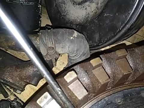

Hmm, did not work, I see connection number 2 to the pto and the hydraulic, but the drive is hidden.
Is it possible to inject something that solves the whole thing without destroying the slats? (slats is it the word for the disc in the clutch? )

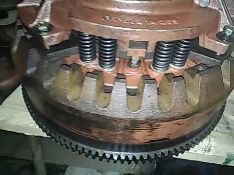

My clutch looks like this, it is the clutch on the left that is stuck, it is not visible in my picture, so I can not do anything about it.
Thanks Tone, but the disc is stuck on the flywheel not on the pressure plate.

Jan, if you depress the clutch pedal, does the thrust plate rise? Let the woman press the pedal, and you try to loosen the lamella with a curved screwdriver, heat a larger screwdriver and bend it by 45 *, the curve should be about 5cm from the end, slowly turn the flywheel and try in different places, maybe it will work.
Yes, the pressure plate is moving, I’ll see if there is room to try your trick.
Hmm, looks like mine is narrower, does not get in such a large screwdriver, only a very thin one.
Thank you, thank you, thank you Tone, I sharpened a screwdriver so I got into the disc, only after 1/4 of a turn it started to sound different, and now the clutch works, Thanks again.
