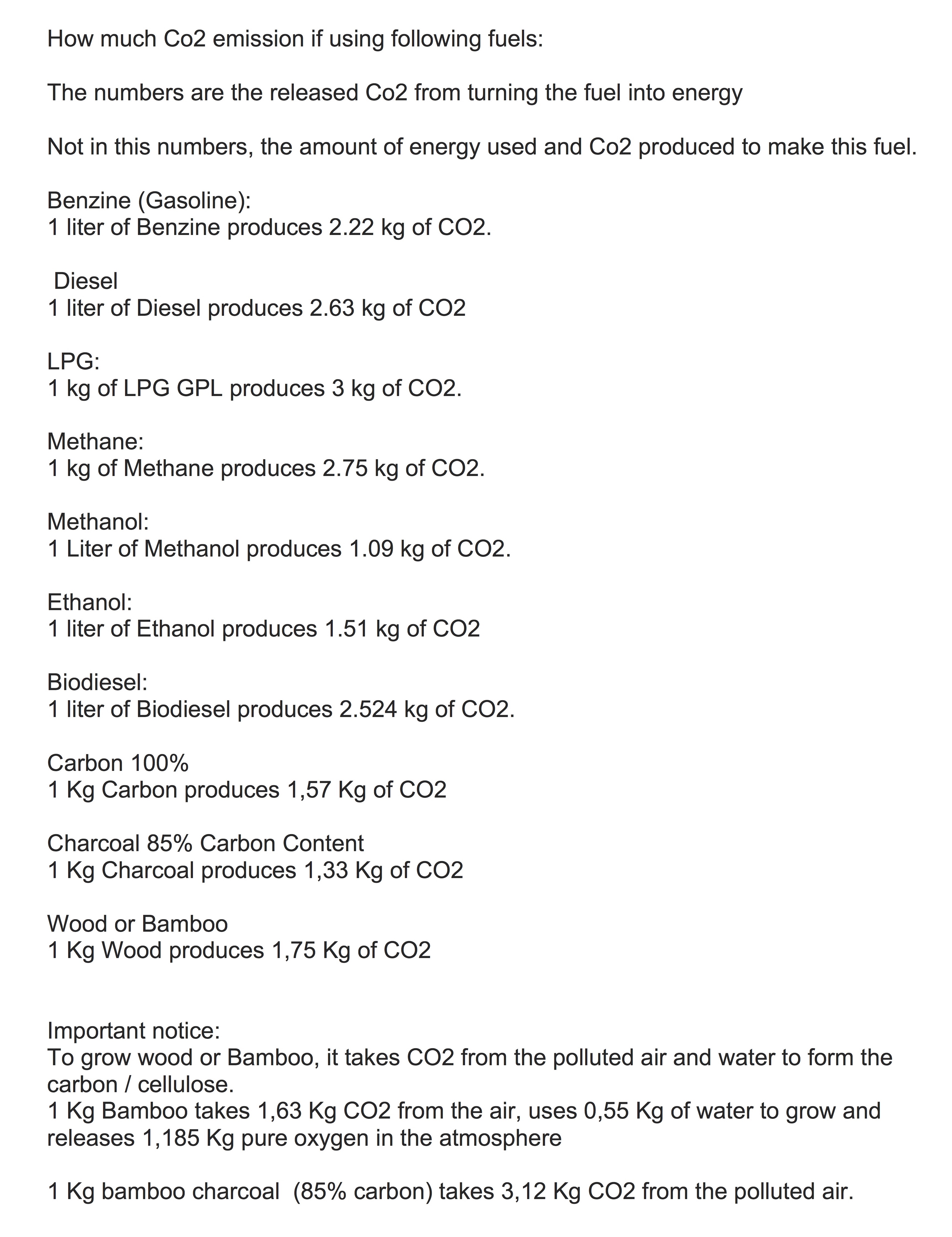

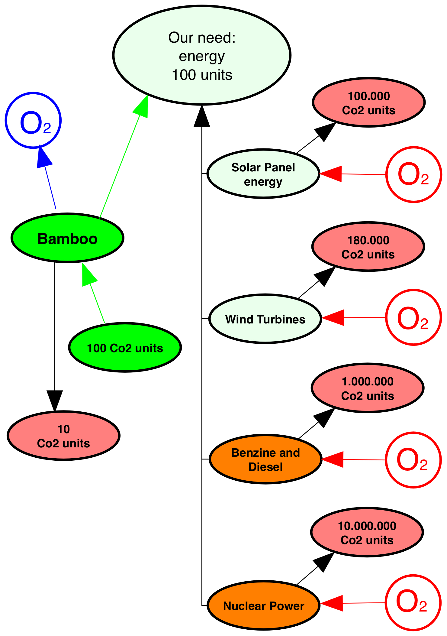

Why DOW or DOC is better then using fossil fuel
Just finished writing together numbers, food for thoughts.
sharing this with you guy’s, coz i love the topic so much…
This is a basic outlining for some governmental office. They would like numbers to play with, so i have them…
The note needs to be more prominent. I also wanted to ask when you calculated how much CO2 is pulled from the air by plants does that account for the mass of carbon in roots that is not used as fuel? I fine one of the strongest arguments for bio fuel is the fact that roots stay in the ground and it takes carbon to grow the roots.
Great number but we can’t understate the fact that every atom of carbon we pull out of the ground is one more atom of carbon changing the atmosphere.
Interesting document. This is of course based on the assumption that carbon/co2 is BAD, as the propaganda tells us.
Indeed Dan,
its about growing the “wood/cellulose/carbon” with the Co2 from the air, subsequently using this as for generating fuel/energy instead of digging up sequestered old stuf aka fossil fuel.
The calculations are based on real measured value’s / mole’s , of the chemical components in the celluloses, tissue and carbons from woody biomass materials.
@Andrew, Carbon or CO2 is not bad, its just using the wrong source and using it in an unbalanced way.

The document is made by myself, data extracted and or tested by myself, from many sources, research documents.
the fact that the amount of Co2 present in our atmosphere is nearly doubled in the last 70 years, but also the world population, is undeniable.

I’m a little confused here.
If it takes ~ 16 pounds of wood to equal 1 gallon of gasoline, is this chart comparing apples to apples? Should the volumes be equal when comparing the amount of energy they contain to compare the amount of CO2 emissions?
Hi Bill,
Another chart, comparing the energetic properties, might be helpful yes.
But this chart was intended to point out how much Co2 any fuel really emits, just for giving it a real value.
I have somewhere another chart comparing fuels yes. a little tricky to mix it with this chart

Hi Koen. A great breakdown.
But I agree with others that it is only one facet of the energy comparison. There probably is no single way to compare all energy sources when considering the different environmental benefits and costs, or at least it gets very complex.
One thing that jumps out at me is the (very complicated) calculations taking into account all the energy inputs to arrive at the fuel product.
For example, they say that between refining and extraction, then transportation and handling, (never mind wars), over half of the embodied energy and thus the emissions of a gallon of gas is spent before being poured into a gas tank.
Biodiesel or ethanol are other difficult cases, as they say modern agriculture burns 10 calories of fuel energy for every 1 calorie food energy produced, and then fermentation and distillation will possibly cut that “efficiency” in half, biodiesel delivering greater efficiency. So the true emissions for those sources are probably off the chart. But if third world or small farming is the source, it will look far better.
Modern logging isn’t so great either, the Canadian industry standard is something like 2 gallons of diesel per cubic meter of timber extracted. That will not count milling, kiln drying and transportation to market. But if the wood comes from the back woodlot, completely different calculation. The power used to make chips, or pellets will be significant factors increasing true energy spent and emissions.
Energy source doesn’t necessarily equal green, it might just be green washing, or maybe I could call it green wrapping. It might have been green to start with
Thierry is correct in his statement that managed forests retain more carbon and are more dynamic. But forests reach a point of maximum biomass and carbon retention, and then are just neutral, they would forever lose as much carbon as they gain roughly in balance. But compared to cleared farm land, they retain vast amounts of carbon in soil and biomass.
So it’s a very important consideration how the fuel is gotten and prepared. Local will always win. Some processing and transportation schemes actually make no sense compared to alternatives. I subscribe to @SteveUnruh when he says use local, and self gotten resources. Extended a bit further, I think this rules out cities as sustainable. People need to have their resources largely at hand, and use those first over others. That also minimizes waste issues. 5 pigs in a pen is no worry at all. 5,000 in a barn is a serious sewage disposal issue, transportation issue, resource gathering issue.
I will certainly be looking forward to more thoughts on this topic.
