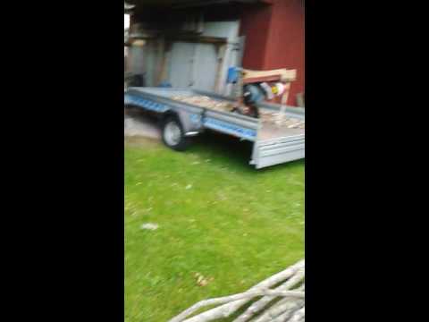

Since Kristijan is having so much fun these days, I wanted some too.
I went down by the river last night and delimbed a small batch of young growth until the mosquitoes chased me home. This morning I went for another one up by the power line until the horse-flies chased me home to the rebak chunker.

I wuld gladly give you (and all others) the plans, but the truth is l dont have any. I envited the guy that made it to come at my place sone time ago, we drunk a couple of beers and made some sketches. Thats more or less it.
The sketches are all based on JOs design. Dont be fooled with all the fancy bolts and frame, its a super simple machine.

I belive double cutter machines may be able to cut slightly sturdier limbs still using a small cutter diameter (short chunks). On the other hand the single axel machine would be a lot easier to fabricate. Needs no machined gears.
This is a pretty naked machine that allows you to see what’s going on.
I did some work on rotary dye cutting machine for labels a few years back they use a rotary cutter wheel with different knife spacing to get the correct label length running against a mandrel roller on the bottom side. The circumference distance between the knives determined the cut length assuming the media travels at the same surface speed with no slippage. I assumed the reason for to knife wheels on these clunkers is to insure one knife is alway engaged in the wood pulling it through the machine until it is cut off. With only one knife wheel and a smooth surface on the other side I think there would be alot of slippage and prices of wood just not pulling through the machine. Only speculation on my part but you can see a similar problem with a wood chipper working against a sheer bar.

My gear diameters are 120 mm and I know Kristijan is using 90 mm. Gives 2-3 inch chunks with four cuts per rev.
I did mine the farmers way with 50 mm square tubing as shafts and 6 mm ss plates as knifes. I attached them this way:
Thanks, did you weld round shafts inside square tubes? What size shaft bearings? How wide, and long are the knives? Sorry for all the questions, thought it may help us get a better idea of it.
Hi Al,
The gears that fell in my lap happened to have bearings pressed into them. I pressed my own into the square tubing and bolted it to the gears. My 20 mm bolt shafts go through all them bearings. Bolts are at a standstill and attached to the frame. The bearings outer size I don’t remember but whatever fits into a 50 mm square tube. The knifes are 120/2+50/2 = 85 mm long and as wide as the bolts allowed, which in my case was about 5 inches. The narrower machine the sturdier. Less flex. If the gears had not come with bearings in them I would have made the gears go outside the frame and bearings onto it (the frame).
