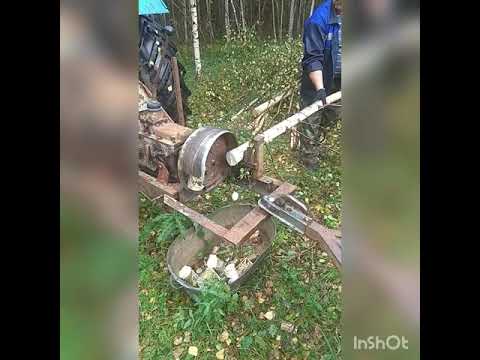

What thickness should it be on the knife on a wood cut built on a rear axle?
I trying to make a wood cut for the tractor, how thick does the sheet that cuts the wood need to be?
Just enough to hold up :smile:
From what I’ve seen, most people use rims (maybe 3mm???)
Lots of depends here. What kind of wood, what thickness and so on. I’ve even seen some youtubers use a support bearing to relieve axle and rim from too much bending force.
I would suggest putting a slip clutch on there as well. It will stop the chipper from back powering the tractor with shock force. They are common on most all implements and pretty cheap compared to splitting a tractor to rebuild the transmission. Having done that job 3 times recently and having a 4th tractor needing it from normal age related issues I would try to avoid any chance of abuse.
…and a flywheel…
I have smatter coupling on the PTO shaft, do you think that’s enough?
unnamed
Something like that baler clutch and flywheel would be my recommendation.
