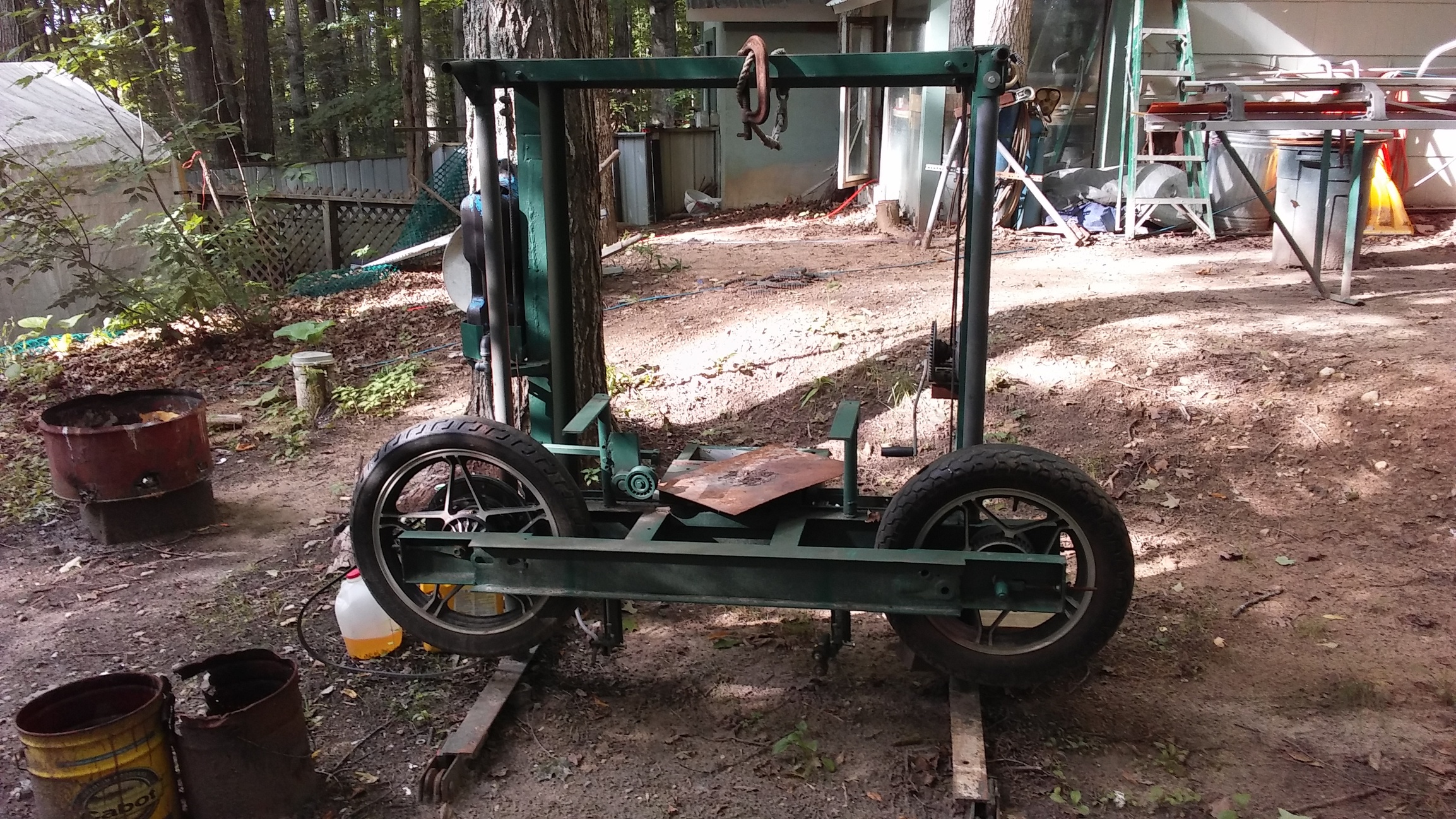

I am having Saw envy Dan. I have long wanted a commercial grade saw like your big Stihl’s but couldn’t justify the cost. Most of my wood is on fairly steep hillsides. Takes a lot of effort just to get the firewood. A log arch wouldn’t do me any good and I could use the neighbors FEL but I’d probably roll the tractor over trying. I do have a winch and a few snatch blocks I manage to snake an occasional saw log down with. Pressure wash it so I don’t eat up my blades. Been a couple of years since I have sawn any lumber anyway. This is the carriage for my mill. I had the tracks mounted on a trailer but hooked a wheel moving and put a twist in the frame that I couldn’t straighten so I pulled it apart to re-do it a other things got ahead in the endless to-do list. This is my home made carriage made out of motorcycle wheels. When the engine is on it it’s just a 420 cc preditor. Works fine if you take your time. Certainly not a Wood Mizer. I want to set it back up with a fixed carriage so I can run it off wood gas. Just need to get double the amount of track.

I do like your homemade sawmill head it is basically the same design as my mill. I was worried about the rubber tires before I bought mine but it works great or atleast it seems that way to me. I will admit I have no other experience to compare it to.
I heard that running the blade on tires takes the set out of the blades, but I ground the crown of the tire flat and take care to keep everything running true so that the cutting teeth are shifted a little forward of the flat andnot actually running on the rubber. Never seen a Pasquali. I’ll have to look that up. I actually do own a tractor. It’s a 1958 MF TO35. Another thing I bought and parked 15 years ago and it sits weathering away. It would probably run. Glow plugs were shot and they wanted 65 bucks a pop even then. Maybe I’ll do something with it some day. I wanted to keep it because even though a tractor like that isn’t worth much, if you go out and try and buy a four cylinder diesel like that it would be big bucks.

Oh I have no idea about the tires and the set of the blades. I will have to see if I messed mine up when I was using the new blades. Next on my list of investments is a grinder and setter for my bandsaw. After using it some it seems like i will use the mill enough to make them pay for themselves over time.
I haven’t resharpened or reset any blades yet. When I built the mill I bought a bunch of Wood Mizer blades. Can’t remember how many but I think they cost something like 360. I have a tooth setter I got from some guy in Tenn because he got an automated one. I have heard of people carefully tapping them with a hammer to reset them but I think that would take a degree of experience. I have seen on the web were people built blade sharpeners out of reworked miter saws.
