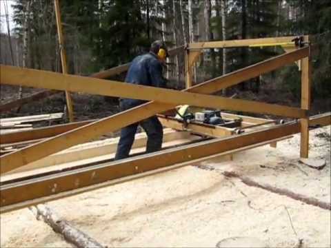

I have to say that is a very cool setup. It is the only machine I have seen that will cut both vertically and horizontally with the same blade and not require you roll the log.
The electric motor also helps with that design. Around here the bulk of our mills are powered by small gas motors 25 hp V twin honda motors are really common I wouldn’t want to flip one of those every pass.
But I am slightly confused. How does the blade cut in both pushing and pulling? Shouldn’t the rotation of the blade and the profile of the teeth only want to cut in one direction?

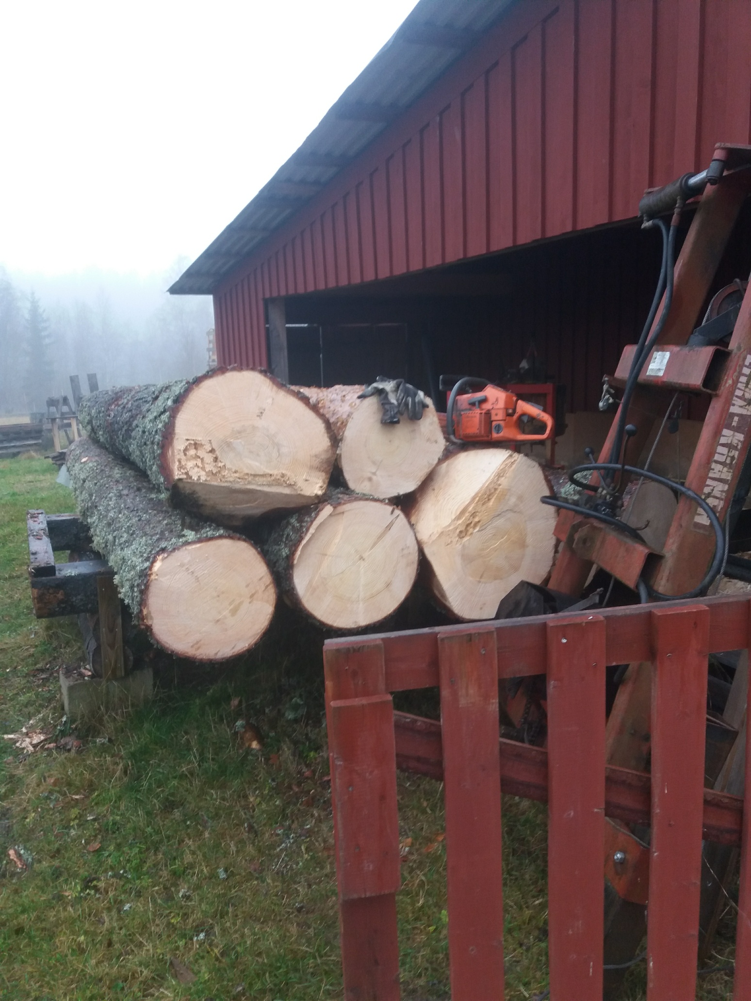

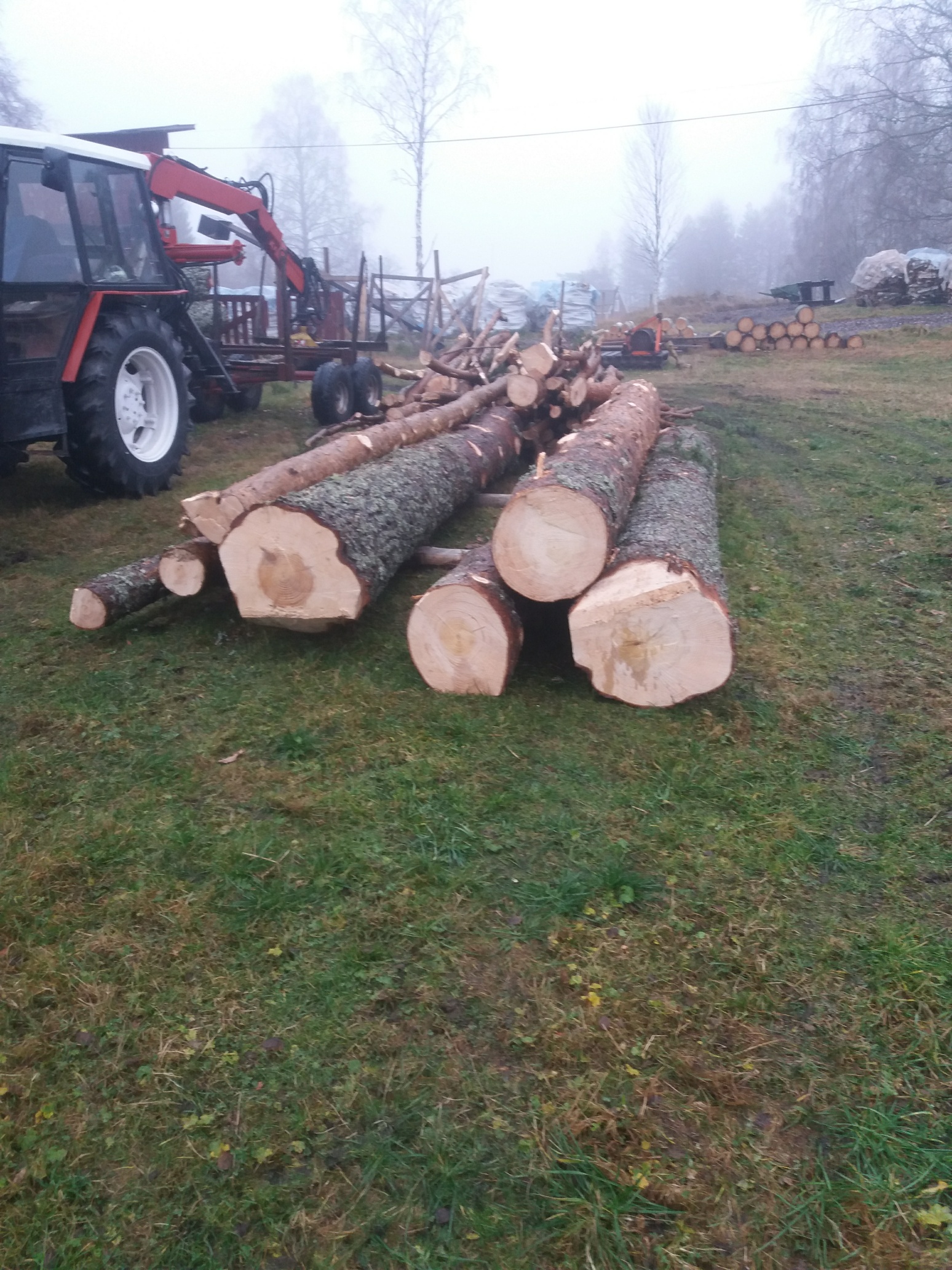

I would need it now, has helped a neighbor drive away some pine from his farm today.
The widest was 24 "in diameter and 5 meters long.

Dan, on a spinning wheel the rubber travels opposite directions on top vs bottom. Sorry, I couldn’t resist :smile: Both opposite sides of the blade are used, and yes, the teeth always have to cut in the same direction you’re pushing or pulling the sawhead. If not, the teeth can start climbing out of the cut and the sawhead will jump half a mile into the woods.

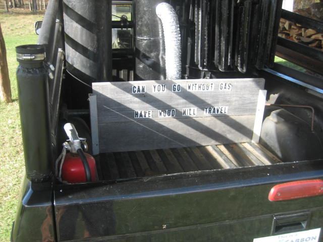

Have Wood Will Travel

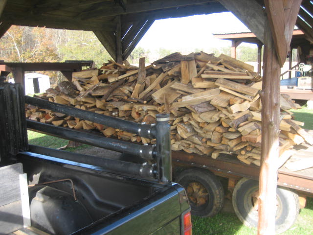

Have Wood Will Stay Warm
