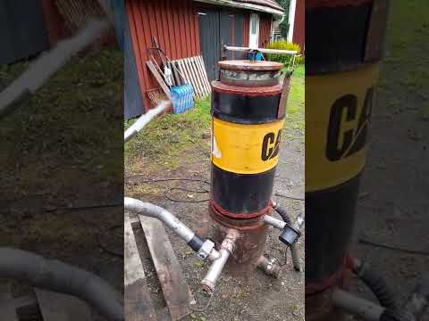

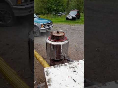

This is what the gas looks like when starting up the S10, after the radiator, much less water.

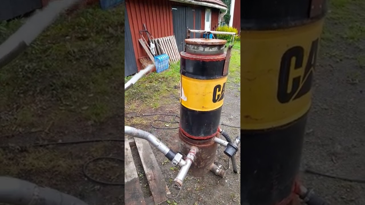

Hmm, I tested with a larger diameter today, I think I have to give up with the diameter, there was no major difference in the gas from the fiberglass filter.
Quite a lot of water even now, and the washing machine drum was not tight either, just more problems.
What is it that makes me get drier gas at the start of the S10, anyone who understands?
Jan, can you post a skech with measurments of your current gasifiers hearth measurments and fuel size?
Jan, it all seems ok. Have you put hazelnut size charcoal in the gasifier over the nozzles when you first lit it? Its important to put in an exess as it settles down when first fired up and can lead to incomplete reaction.
Second, for a gasifier this size, your blower might be on the small side, not heating the gasifier enaugh.
But since you seem to have this problem often, it might be the fuel. Not sure how since you got a condensating hopper but it can be the case. In this case the only cure l can think of is mixing in 10% by volume of charcoal.
I have charcoal up over the nozzles.
I have only run the new unit, at home on the farm, (3 times) wondering if I still have moisture left in the ashtray.
The wood is the same as I have in the S10, so there is no difference.
The gas goes through the cooling pipes on the S10 before I see it, so they may also take out water.
